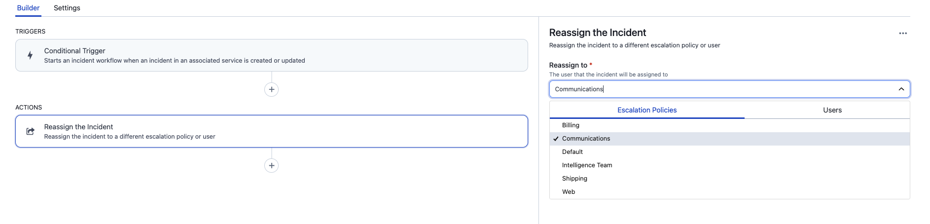

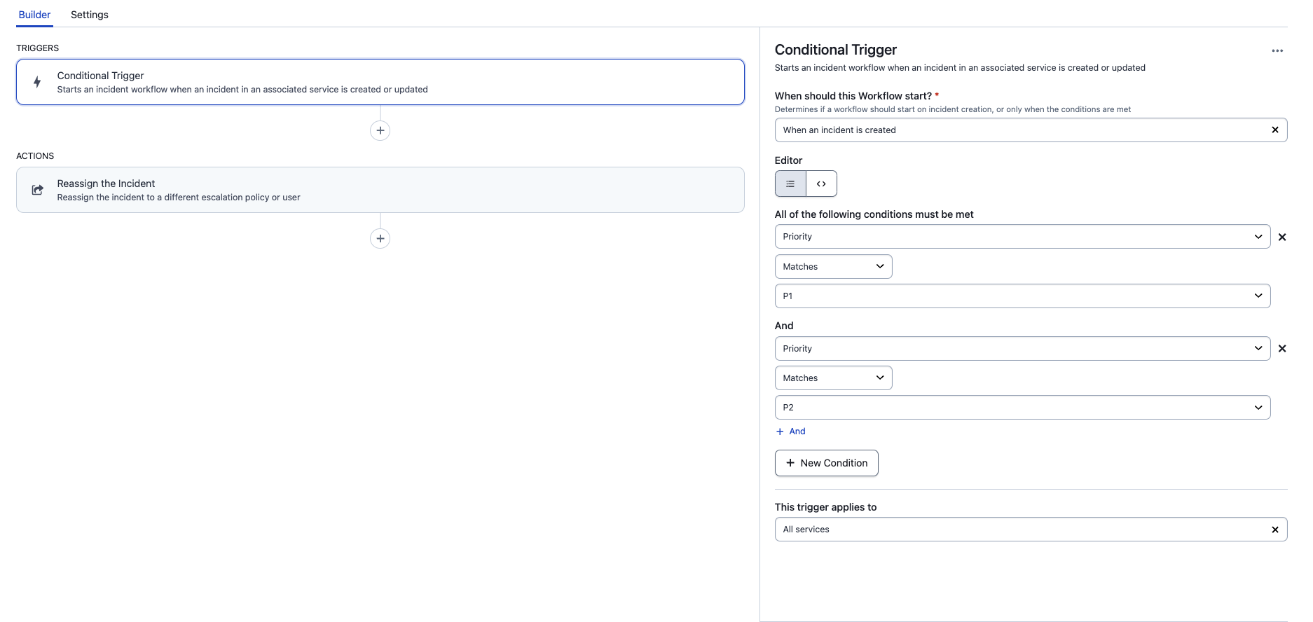

Yes, you can do this easily with Incident Workflows.
You would setup the trigger and conditions that you want to match
And then you define the action. In this case you would want to reassign the incident to a specific Escalation Policy if I understood correctly.
I hope this helps!
